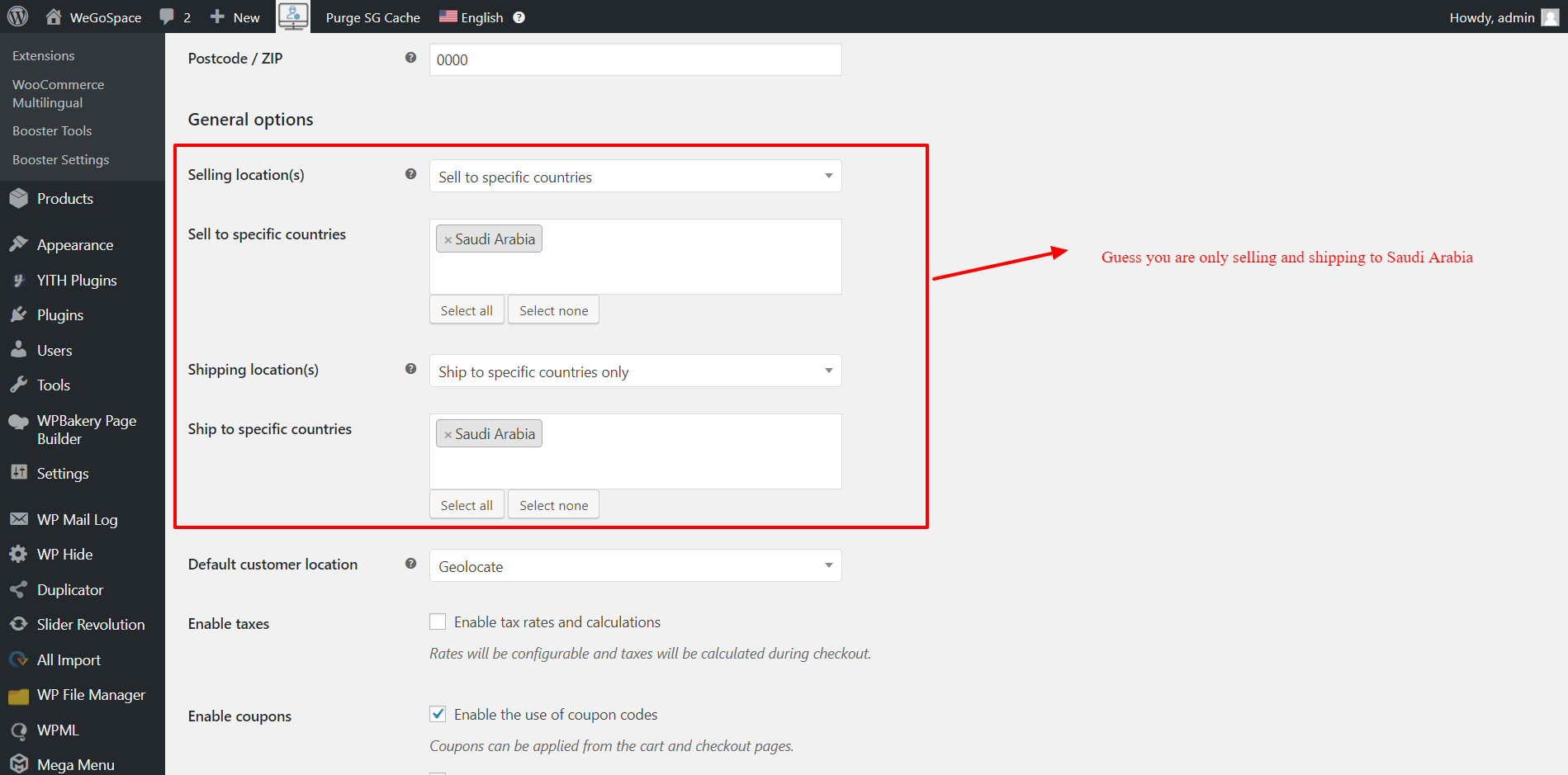

      Hope you are using only selling and shipping in Saudi Arabia. In that case, I guess you can try out Shipping by Country instead of Shipping by Zone.
      You need to restrict selling and shipping country to Saudi Arabia in Woocomerce Settings panel ( Screenshot Attached ). And from vendor dashboard vendor needs to select states in country Saudi Arabia and set the shipping costs as required ( Screenshot Attached ). We can hide the additional fields in Shipping by Country which are not required by you. I have set up shipping by country for the test vendor Vendor50.

      In the point 1 you mentioned, if the admin restricts the Shipping Locations to specific countries ie ( Shipping Location(s) -> Ship to specific countries only )
      Then all the shipping countries for all the vendors and the customers will be restricted to the countries specified there. In the shipping calculator also the countries will be restricted. This is the default WooCommerce flow.
      So if you want to have some vendors ship to all the world, it is better to keep the shipping countries unrestricted from the admin end and let the vendors choose between country wise shipping and zone wise shipping.
