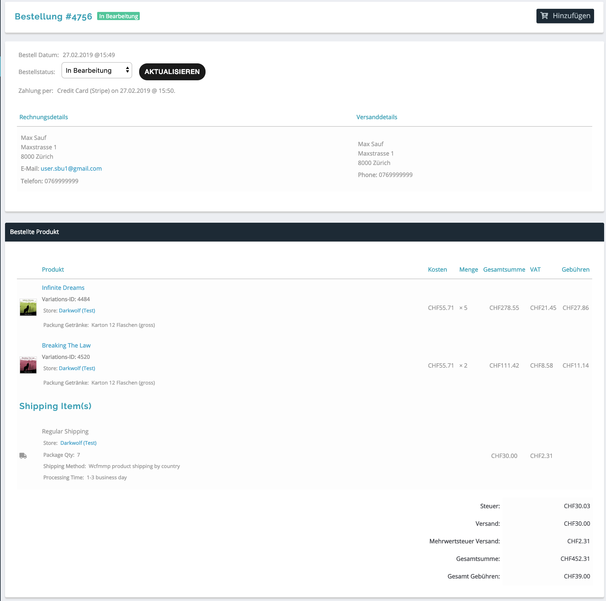

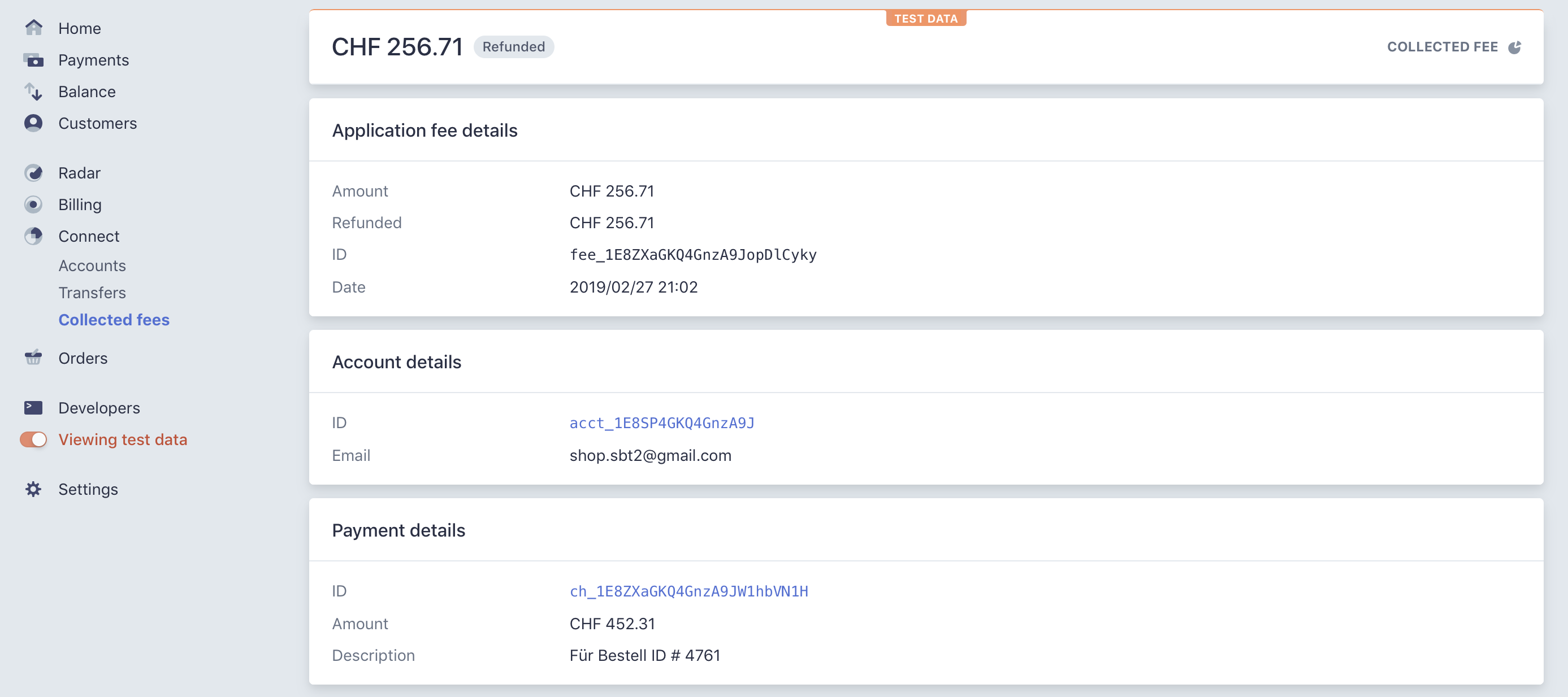

I am testing Stripe Split Payment (direct charges) on Woocommerce Multivendor Marketplace / WCFMU. I collect a 10% fee from the vendor. The charges (fee) are correctly displayed in the order. The problem appears on the Stripe side:
– When ordering exactly 1 item, the charges are collected correctly by Stripe. -> See Attachment “OK – Stripe collected fee 4754” and “Order 4754”
– When ordering more than 1 item (I tested with 2, 3, etc), the charges collected by Stripe are wrong (much too high). -> See Attachment “Error – Stripe collected fee 4756” and “Order 4756”The error remains, whether setting a commission for admin of 10% or a commission for vendor of 90%.
Is there a mistake in the passing of the arguments from WCMM to Stripe Split Payment. Could you please help me fix this issue? Thanks!

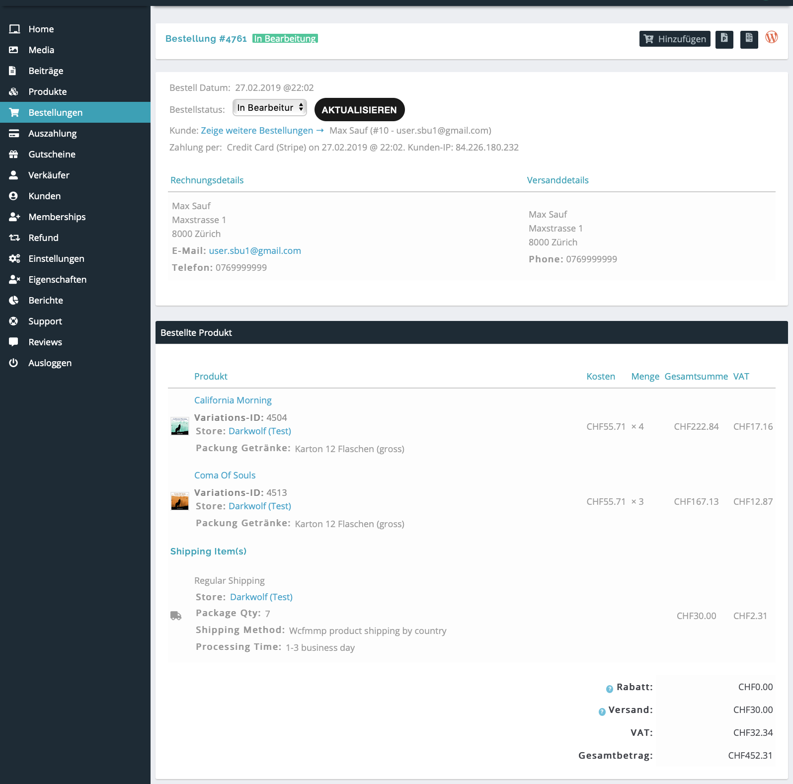

*** But this order does not generate with such commission setting. It’s generated with Commission For “Admin” – https://wclovers.com/wp-content/uploads/2019/02/Order-4756.png
That’s why I asked you to test this once more using Commission For “Vendor”.
- February 28, 2019 at 10:13 am #50546
- March 1, 2019 at 4:33 pm #50794
https://wclovers.com/wp-content/uploads/2019/02/Screenshot-2019-02-28-at-11.05.02.png
– Why it’s refunded?
https://wclovers.com/wp-content/uploads/2019/02/Screenshot-2019-02-28-at-11.01.04.png
– Can you please give me order details screenshot as vendor login?
- March 1, 2019 at 7:38 pm #50797
shitT
ParticipantHi
It’s refunded, because I tested the refund function later.
In the attachment, you get a screenshot as the vendor sees it.
Could you reproduce the case on your systems (calculation OK with 1 position, not OK with 2 positions or more.)?
Kind Regards,
GilbertAttachments:
