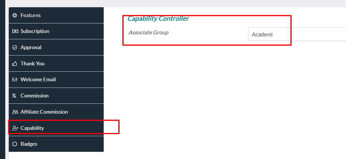

ParticipantI just got the Groups & staff add on, but I cannot see the available groups in the registration form, how do I add that?
- May 6, 2020 at 1:17 pm #127310
Sarmistha Chakraborty
MemberHello,
You have to assign group in each membership plan (PFA)
Please check the Documentation : https://wclovers.com/knowledgebase/wcfm-groups-staffs/Thanks.

eritechdeveloper
ParticipantThank you, but that only allows me to associate 1 group to 1 membership plan. I want to associate multiple or all groups to it.
Or are you recommending I create multiple memberships 1 for each for group?
- May 6, 2020 at 7:07 pm #127519
MemberHello,
Yes, create multiple memberships 1 for each for group.
Basically You cannot assign many groups in one membership plan, but in many membership plan you can assign one group.
Hope it’s clear to you.Thanks.
