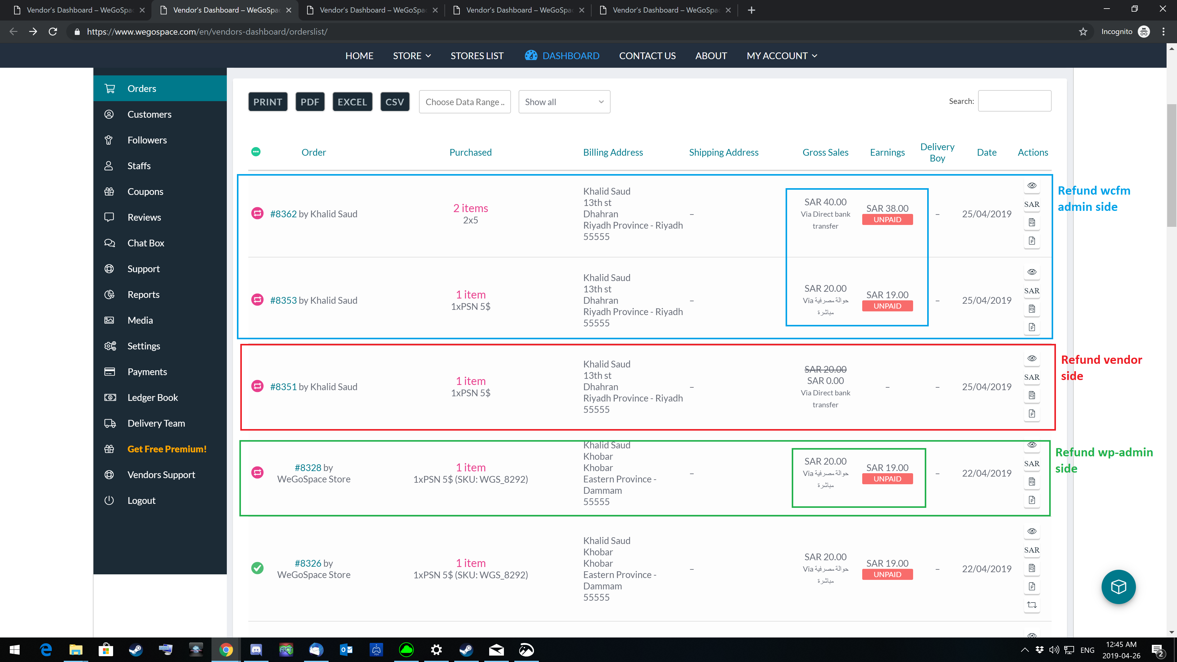

  • in reply to: Refund possible bug ? #60193
    d-n-13
    i did inwp-admin but wcfm orders labels did not update : https://wclovers.com/wp-content/uploads/2019/04/refund-bug.png
    in reply to: Refund possible bug ? #59865
    d-n-13
    – Do you have refund this by directly change order status to “refunded”?
    Yes in wcfm, and in wp-admin i did do refund function normally.
    Currently only vendors & customer can request refund. Admin does not have a way to refund properly for wcfm.
